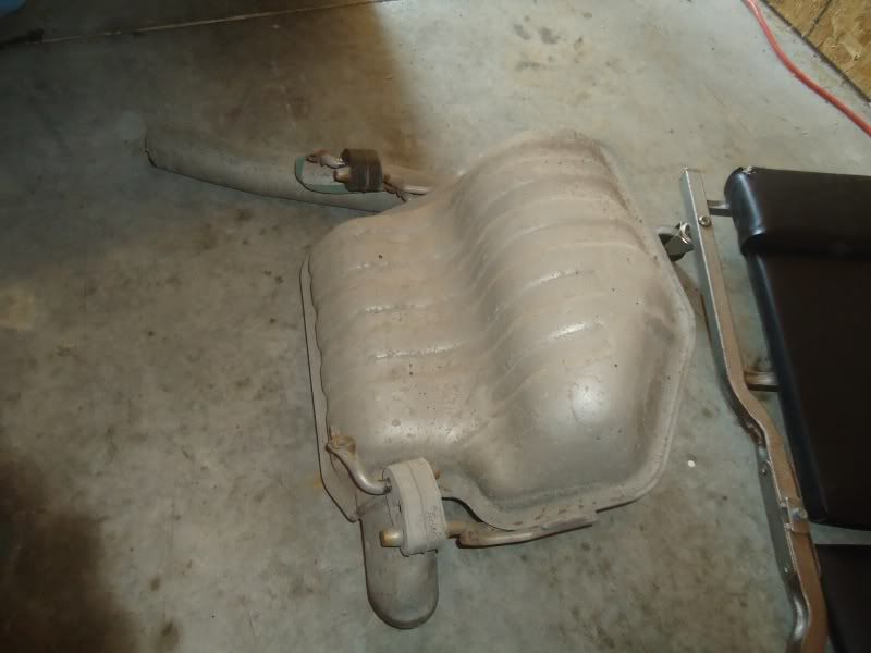

After both these 13mm bolts are removed the resonator will come off. You should be left with a gap like so:
This is what you should have cut out:

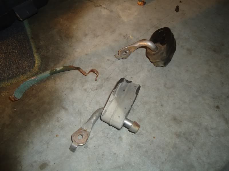

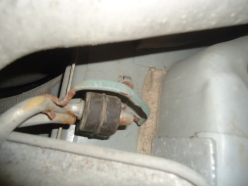

Now you have to remove the hangers to put on the BB pipe. Here is a picture with arrows that detail where you need to spray WD-40 so they will come off:
Once they are off, you should have this:
You take these two parts and slide them on the BB pipe hooks.

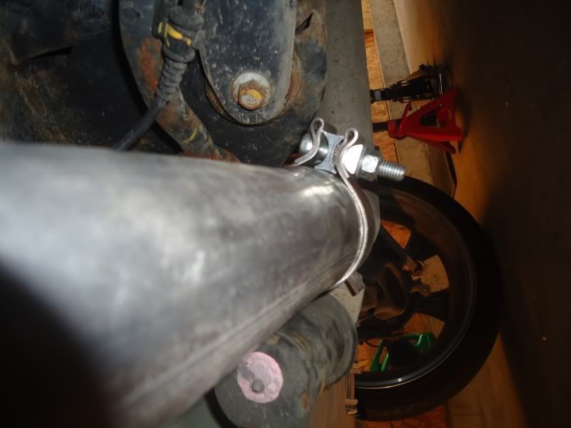

Go back to where you made the cut and tighten that clamp that secures the pipe to the stock exhaust. It is a 15mm bolt. Here is a picture of the clamp:

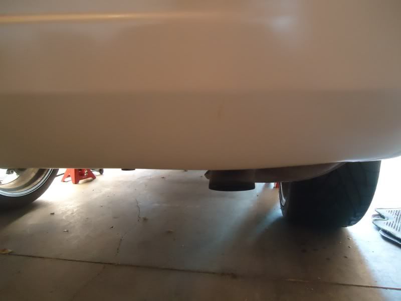

And this what the final outcome was:
