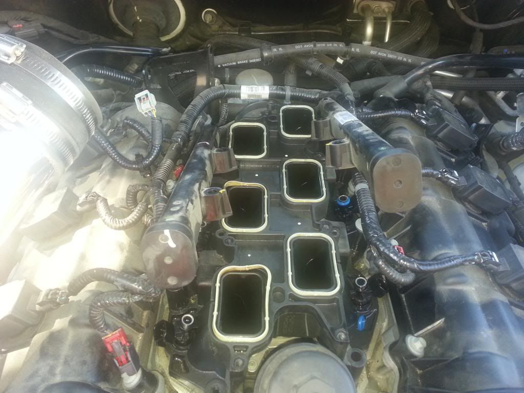

So I got my parts installed today. Not as easy as I would've liked, definitely a few memorable moments.
You see those two twin plastic rods? I don't know if there's any other way, but those must be pulled off, and the result is fuel spewing out all over the place until they've emptied(make sure you've got some gas in the tank).
Here's a picture of everything completely removed. Maybe I'll put together a DIY thread for this installation later.

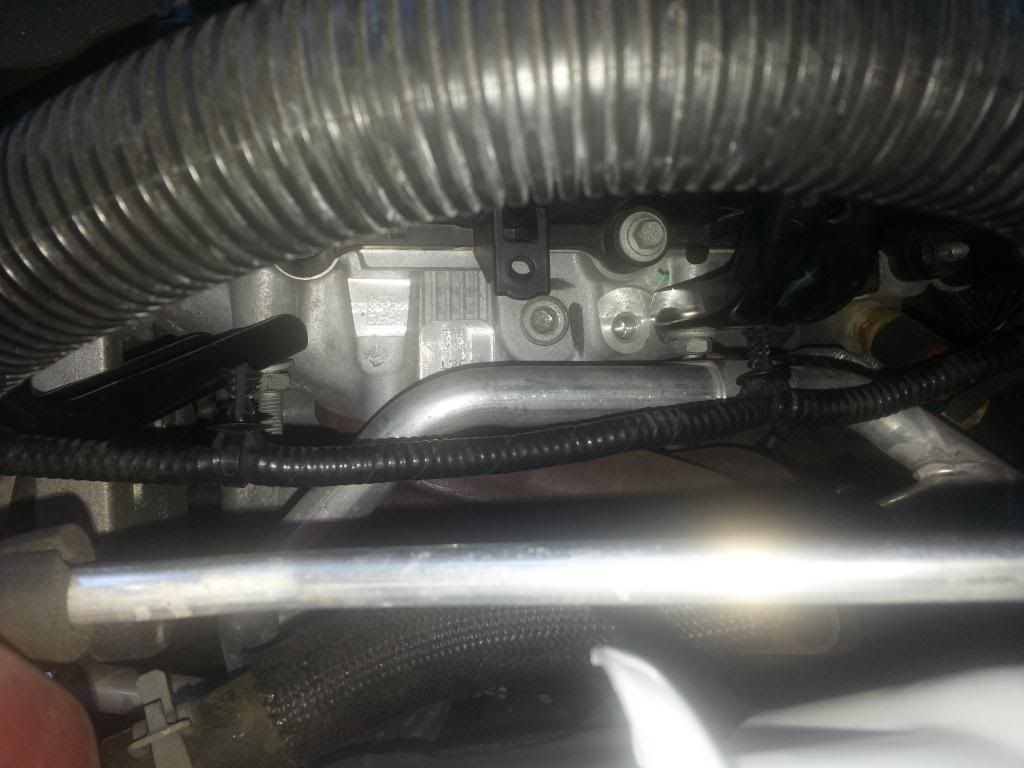

Also, this guy(the 13mm bolt). What a pain in the arse:
Pain in the arse. It's in an extremely tight and awkward position. Definitely takes some patience to loosen it so that you can pull that black bracket off the intake manifold.
