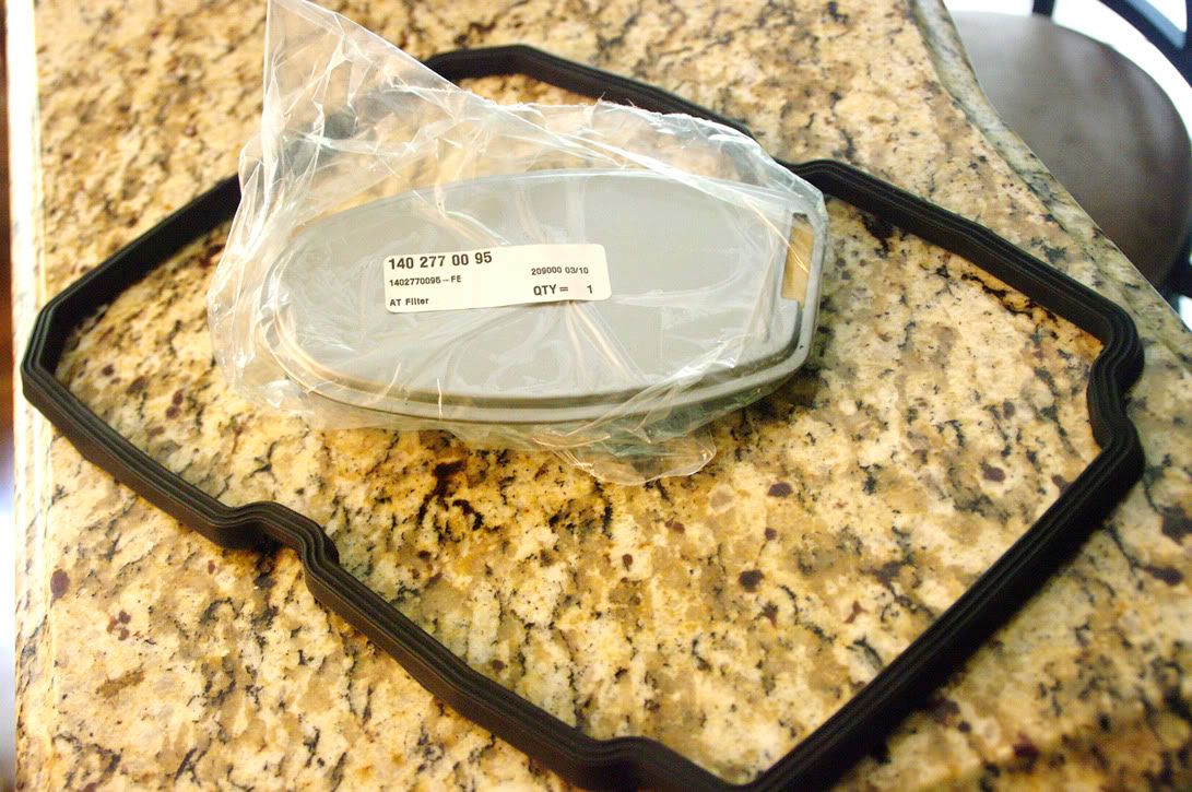

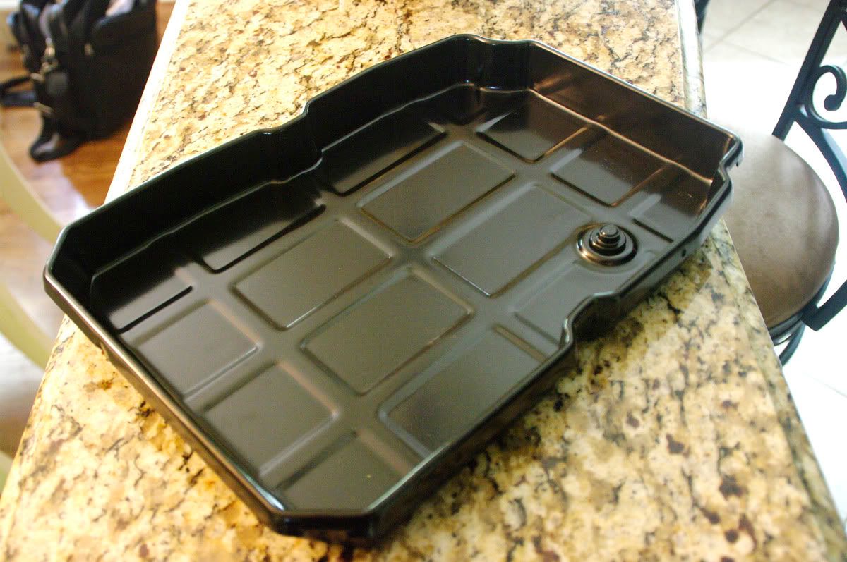

To prepare the car for some events I have decided to upgrade the transmission for some road race ready shifting. Parts cost about $580.00, add another $25.00 for Mobil 1 ATF +4. NAG-1 Trans is the same as the MBenz 722.6
I have selected the following Mercedes Benz (part numbers are all listed) items for the upgrade:
140-270-08-12 Pan with a Allen plug $75.00 plus shipping
169-371-00-03 Pan Magnet $30.00 Plus shipping
140-589-15-21-00 DipStick $70.00 Plus Shipping
140-277-00-95 Pan Gasket & Trans Filter Set $25.00 Plus shipping
240-270-00-89 Blue Top AMG Solenoids (2 required) $180.00 x 2 (plus shipping)
Basically, drop the pan, fluid, and the valve body, replace the brown solenoids with the blue ones, replace valve body, replace fluid and you're good to go.
These should be installed next week, I will let you know how it goes and supply you with more pics. Should be a much snappier aggressively shifting monster!
